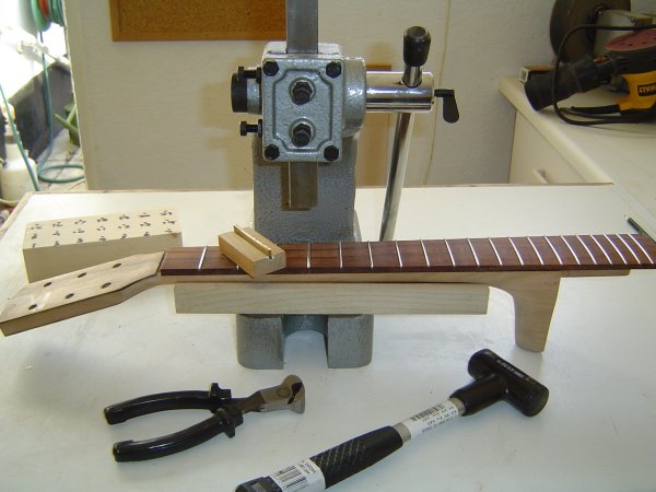

As many of you know I build my necks with an extension for the fingerboard, so my fingerboards are not glued down. I fret my necks off of the guitar after the board is glued to the neck.
The last thing I want to do is start hitting my frets with a hammer, (OK I just tap the ends with a very small dead blow to locate them) so I press them in using an arbor press and a radiused caul in a hardwood block.
Before doing this however I believe the critical part is to get the fingerboard absolutely flat along its length, I will spend some time on this with radiused sanding blocks and a straight edge.
Then, just press them in with the arbor press and once three have gone in, start to check them with a small straight edge for any that are high, and press them in more if needed, I check this every fret as I work along the board.
When finished, clip and dress the ends, and the job is done. I have never had to start running a file along the top of the frets to level them, if the board is level and you check as you go then the fret tops should be level, and if you press them rather than hammer them then they shouldn't have damaged tops either.

I press using a JawsII and my aluminum FB Radius sanding block and the new press attachment for the sanding block ( See StewMac's site).
All this means that I have to be careful pressing and dressing as to not mare my finish but that is not a biggie if you take your time.

I do mine almost exactly like Colin. I use a caul (Cumpiano) under the extension while those are pressed in.

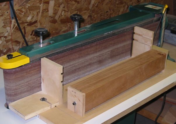

I am also a big fan of pressing frets and I do it on the board before gluing it to the neck.  After pressing, I take the board to a hard, flat surface and hammer them flush with a hard wood block maybe 3/4" x 4".  I do this because I don't think the press seats the frets perfectly in a board with a compond radius.
I've gone back and forth between wicking CA in after the fact and using titebond in the slot and using nothing.  I can't recall ever having a popped fret since I started pressing them so I don't think glue is needed to hold them in.  Some say it makes the fret better connected to the board and gives better tone but I have no opinion on that.
I then take it back to the edge sander to flush sand and bevel the ends.  I just do it carefully by hand with no jigs till I get about 1/64" bevel into the wood.  Quicker and easier than filing by hand.  I stopped triming the ends with snips because it can be hard to do it without wiggling the wire and loosening the fret ends.  I then take off the sharp corners with a flat file, polished on the edge and round and mostly finish the fret ends.  I then glue the board to the neck using a special caul on a flat surface.

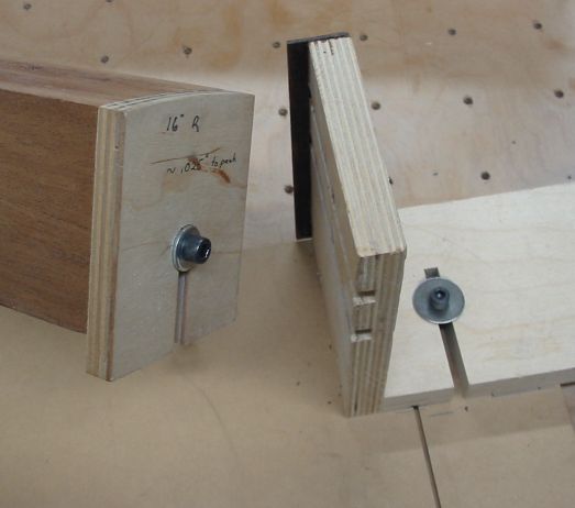

As for me, I slot the fretboard, then radius, then glue it to the neck. Once it's glued to the neck and the neck is shaped I put in a little relief. To get the relief in the right spot, I try to simulate tension by locking the heel mortise in a vise and pushing on the headstock. If the bend isn't happening at the 6-7th fret (where I want the relief centered) I can take out material to compensate. Finally I fret using an arbor press and caul.
For me getting really good playability comes from adding that relief in before fretting. I started doing it this way after Ervin's class and figure I now get the low E string an extra 1/32" closer to the fretboard at the 12th fret without any buzzes using this technique compared to having a perfectly straight board before fretting.

I have a 1a, and the figerboard twists for more relief on the bass side. This is instead of raising the saddle on the bass side. Apparently, Jose Ramirez liked the idea of keeping the saddle a constant height above the top...not what we are used to with steel string guitars. Ramirez action is notably manly; that's quite normal. Those guitars are designed to punch to the back of a 2,500 seat concert hall with no amplification. They also have long scales; they're not for wimps.
Also, we press frets in on all our bolt on Renaissance necks. We hammer them in on guitars where we can't get the neck into the fret press conveniently. Hammering is not that big a deal if you learn how to do it correctly. Of course if you don't, it can be the most frustrating job in lutherie. Taylor hammered frets into hundreds of thousands of guitars before they switched to the new neck joint.
Speaking of production fretting, when I was at Fender Corona a year and a half ago, they were wasting over 20" of fret wire on each Strat neck.   The overhang at each end of the frets was incredible... I'd bet they had a 35% waste factor...

[QUOTE=Kent Chasson]
Thanks for starting this thread, Hesh.
I don't do anything out of the ordinary.  I did find that it was easier to get low action after I switched to a compound radius board.  I have  a simple jig for sanding the radius on an edge sander.[/QUOTE]
Kent - one of the things I have a hard time understanding is how a compound radius is put on a fretboard. A single radius seems straightforward (just use a radius sanding block). You said you have a jig for your edge sander - can you elaborate or post a pic? This may be one of those things that I just don't get until I see it or do it.
Thanks!!
Christian
PostPosted: Tue Jul 17, 2007 7:20 am
Christian: go check out the 'shop pics' on Warmoth's website for a very over-engineerd (but oh so pretty) edge-sander jig for compound radii.
PostPosted: Tue Jul 17, 2007 7:53 am
Christian,
Also, here's a thread from awhile ago. Might answer some of your questions.
PostPosted: Tue Jul 17, 2007 7:55 am
Posts: 1271
Christian, here's the jig.  First, a disclaimer.  When I build a new jig, I almost always build it as a down and dirty prototype.  I leave off any bells and whistles and never put energy into making them look good.  Often the prototype works fine and I use it for years.  If not, I'm not out much time or money and I know how to build it right the next time.
This one was quick and dirty and has worked pretty well but I could recomend some improvements.
The board attaches to the jig with double sided tape (vacuum would be a nice improvement).  There are changeable guides on each end and you can make any single or compound radius by changing the guides.  They adjust for depth sliding on small rails to keep them square to the surface and lock down with an allen head bolt (I put a layer of psa sandpaper in between to really keep it from slipping).  The allen head bolt then acts as a pivot rail and fits into the slots on the stationary part of the jig.  It helps to have a few different slots so you can move the jig around on the belt and not wear it out in one spot.
Here's a detail.  The guides stop on the little rail at the back and those get adjusted as close as possible to the sandpaper and locked down with another bolt.
A helpful refinement would be a simple screw adjustment for depth but it's not to hard to adjust without it.
Hope that's clear.
